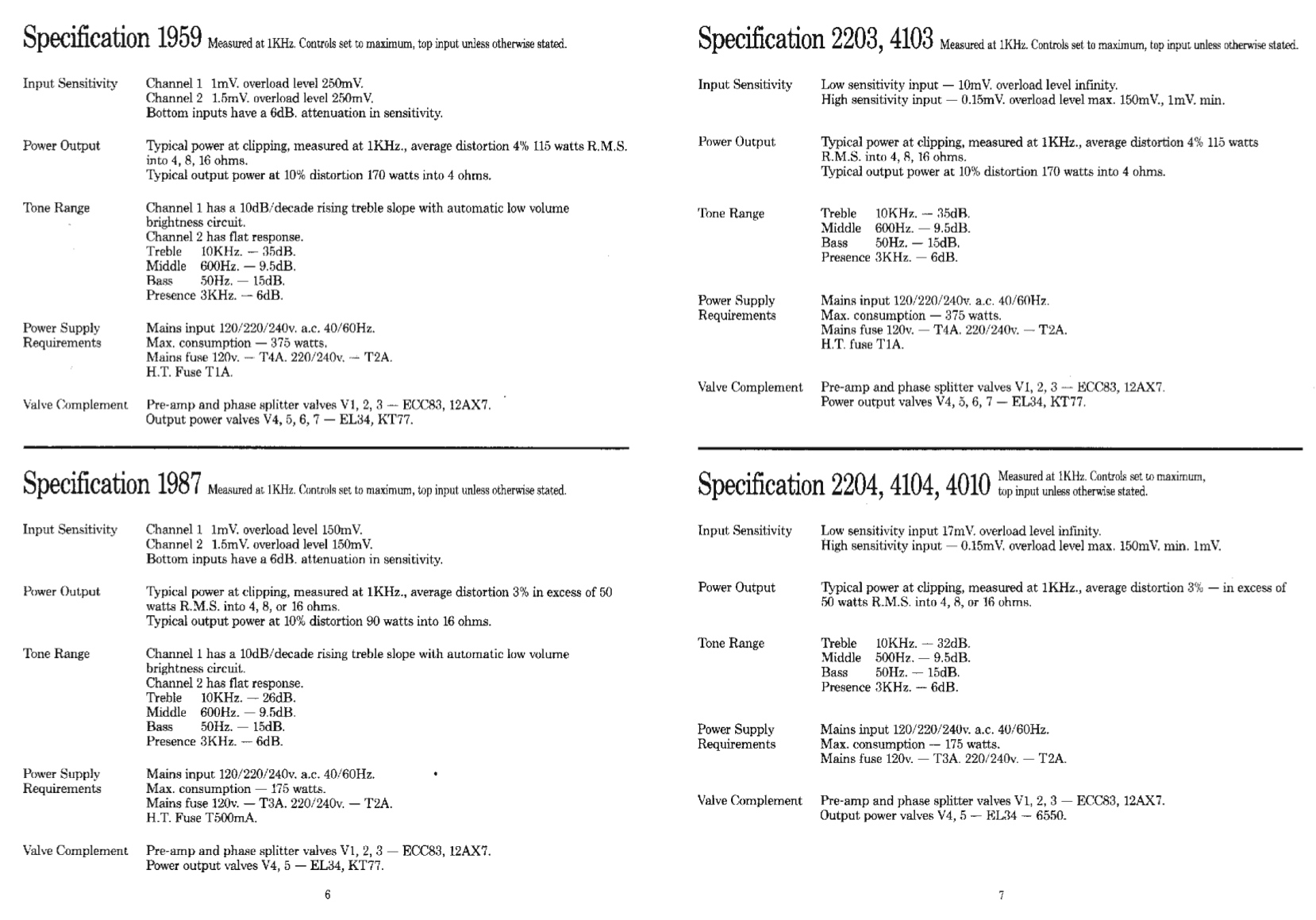

“Pushing the speaker hard sounds best!” Another myth that’s been going on forever. You will eventually ruin the speaker by “pushing it” with overdrive pedals without enough speaker power handling. You cannot run your 100w Marshall on 10 into a single 4x12 cab with four 25w or 30w speakers. Why? Because your amp is rated conservatively. That means once you pass it’s clean tone (3% distortion total) into a singing overdrive tone (naturally with the amp turned up around 6-8) you’ve gone from 100w clean at 4 on the volume knob to 180-200w at 8 on the volume knob. They sold two 4x12 cabs with those old Marshalls for a reason, they knew the speakers would blow. I have a JCM 800 manual available online that shows the 100w JCM 800 put out 115w clean at 3% distortion (4 on the volume knob) and in excess of 170w at 10% distortion (around 8 on the volume knob). Email me if you want it or go to this link to see it yourself.
http://www.scumbackspeakers.com/specs/j ... rspecs.jpg
9) In closing, you can’t just run amok on your amp with your speakers unless you have enough power handling to run amok. Make sense? Towards that end I always recommend you get twice the speaker power handling of your amp’s clean rated power. That means 100w of speaker power handling for a 50w amp if cranked, and 200w for a 100w amp if cranked (or as I like to call it DIMED!). No one wants to fry their speakers or their output transformer after you fry your speakers. It’s expensive, you’re not playing through an amp and most electric guitars aren’t designed to sound good as an acoustic.

7) Square wave signals…these are generated when you use too much fuzz, overdrive, and the tone is so saturated it sends a square wave to the speaker. Speakers don’t tolerate square waves for a long time, they eventually get overheated and hang up in a set position in their excursion and result in getting a voice coil burn or fry. If you’re going to use fuzz, get 3 times the rated power of your amp’s power to offset the heat induced by the square wave. Even then there are no guarantees.
