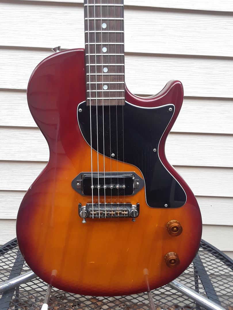

5 coats - not getting a 6th out of that rattle can.
I think I'm pretty close to the target shade.
Glad I ditched the disco ball gold.
View attachment 98533 View attachment 98534
Beautiful job on the amazing transformation of your Maestro guitar !!
I have done a few similar builds and have gravitated toward the Mojoaxe Wraparound bridge.
I have tried many bridges (Faber, Gibson, Tonepros, Pigtail etc...stairstep style depending on the studs) and find the Mojoaxe to be the best. They have 2 different models for offset and parallel studs.http://www.mojoaxe.com/
1st picture is a Cherry Junior build with the offset studs (I used some locking studs to keep the tilt to a minimum https://www.ebay.com/itm/122004247028?hash=item1c680511f4:g:UewAAOSwnF9Y6~T6) and the 2nd picture is a 1960 Epiphone Coronet with the stock parallel studs. Both bridges are from Mojoaxe.

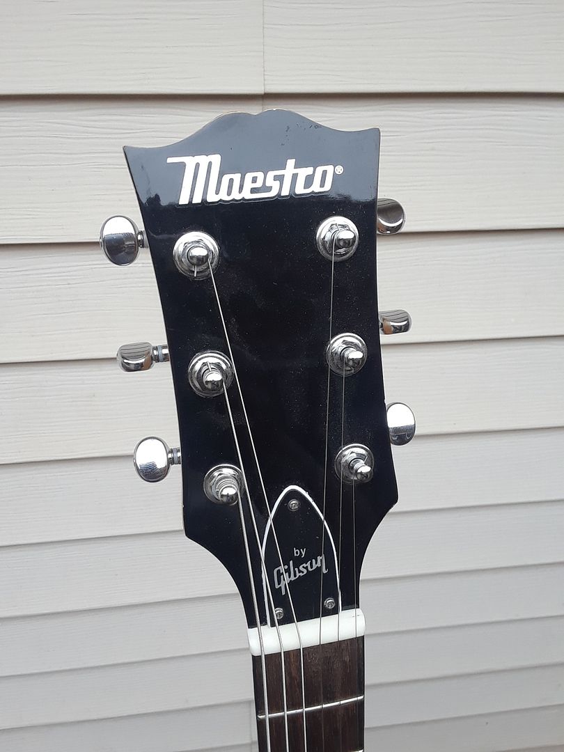

Some finishing touches: (compared with the Gibson)
Went ahead with some new Kaish locking tuners.
I couldn't find anything that matched the tuner spacing in a one piece per side set.
upload_2021-12-6_13-22-30-png.98953
Also noticed that the Gibson had some knob pointers.
And I decided to bling it out with an LPJ head decal.
Final album shot.
I'm calling it done...

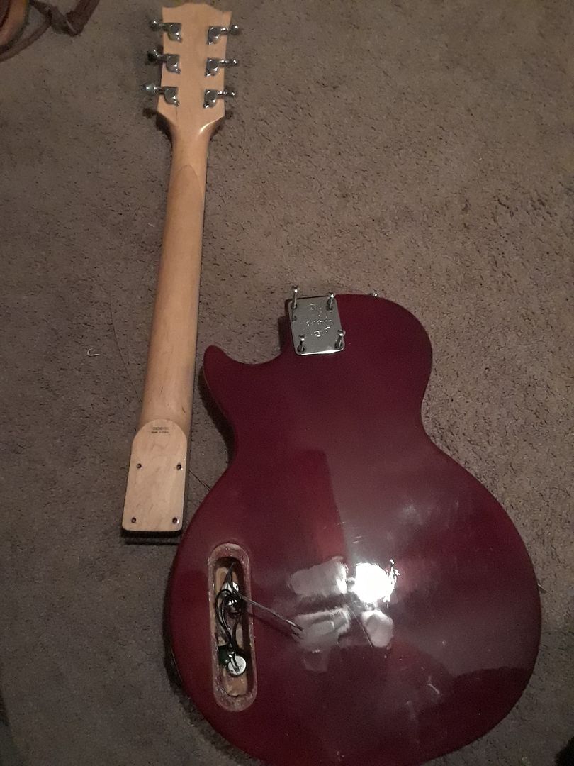

I finally got around to tearin' this one apart......whaddya know , it is NOT plywood
Tryin to get this one together for my British "stash"
Not entirely happy with the neck profile , but it's better than most. The neck on my white one is 1 11/16" at the nut ,most of 'em seem to be about 1 5/8"......doesn't seem like much , but they're night n day
