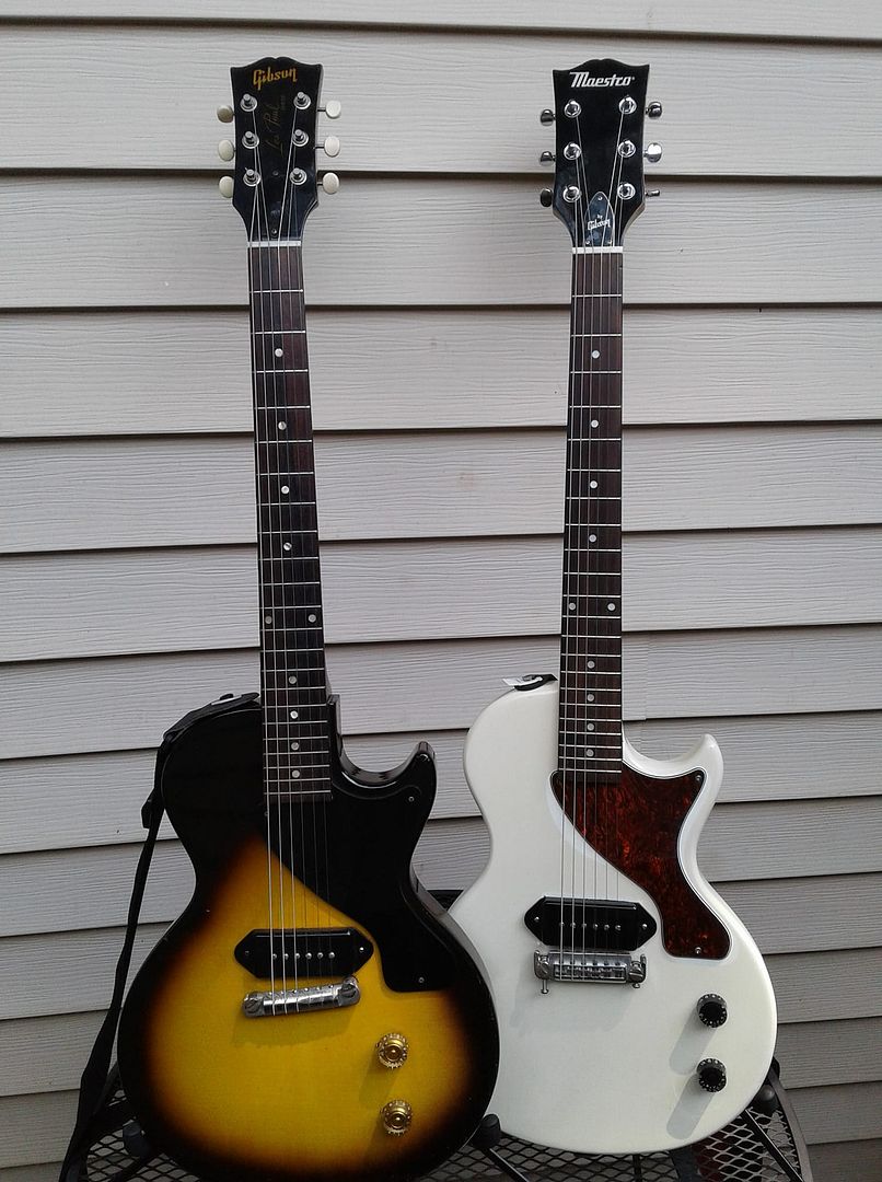

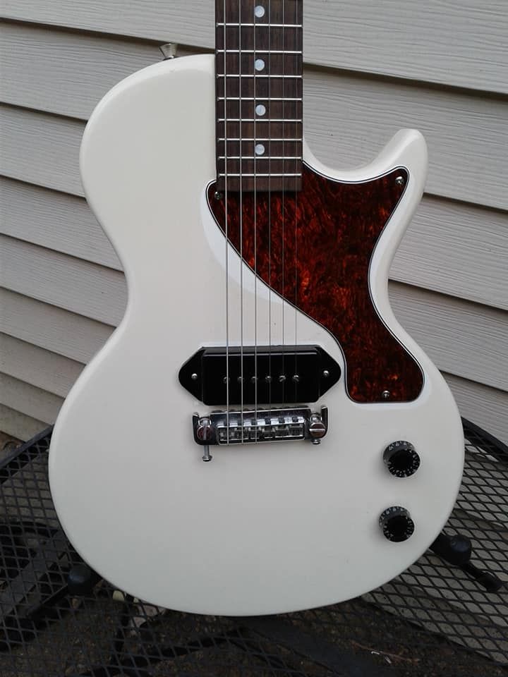

Cool , I find they can be a lotta fun
I went nuts and bought a few of those guitars , bodys n necks last summer when they were very cheap
They screwed the SG by putting the pickup too far away from the bridge ....The SG had a neck that was like a 59-ish LP profile . I noticed they got it right on the Les Paul body , so I started looking for them
Got a couple ,and a couple complete guitars . I still have yet to run across another neck like that one though .
After goin' thru a few combinations of parts , this is the one that ended up being THE guitar !
A great place for that real Badass
Next to the 56 for good measure

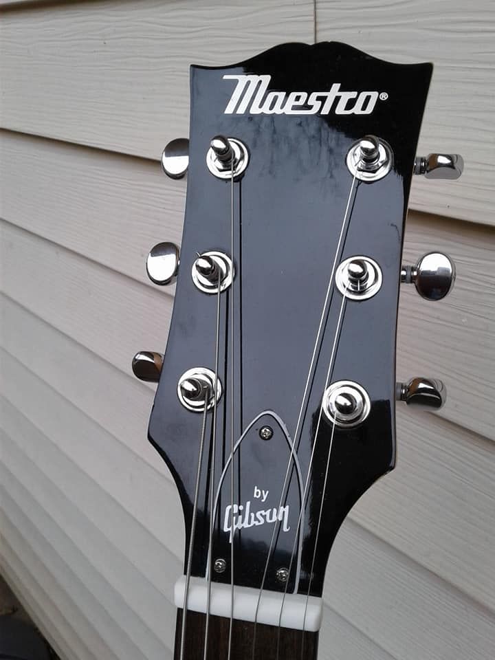

You mean these ,Rick ? I didn't find 'em much better , kinda slight in the neck dept
I used to buy one every year for a raffle at an event I play. Most come, with a way too hot ceramic pickup , some come with one about 9k ,which can sound real cool with a magnet change ....pots / gears are also sh*t. The people who got mine ,got a good setup , new pots ,an A5 magnet and maybe a bone nut if I felt real generous . Before the raffle , I would tune 'em up ....just because
I hate that damn headstock. I have an Epi special that I cut into a Melody Maker headstock
