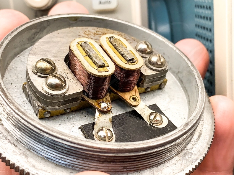

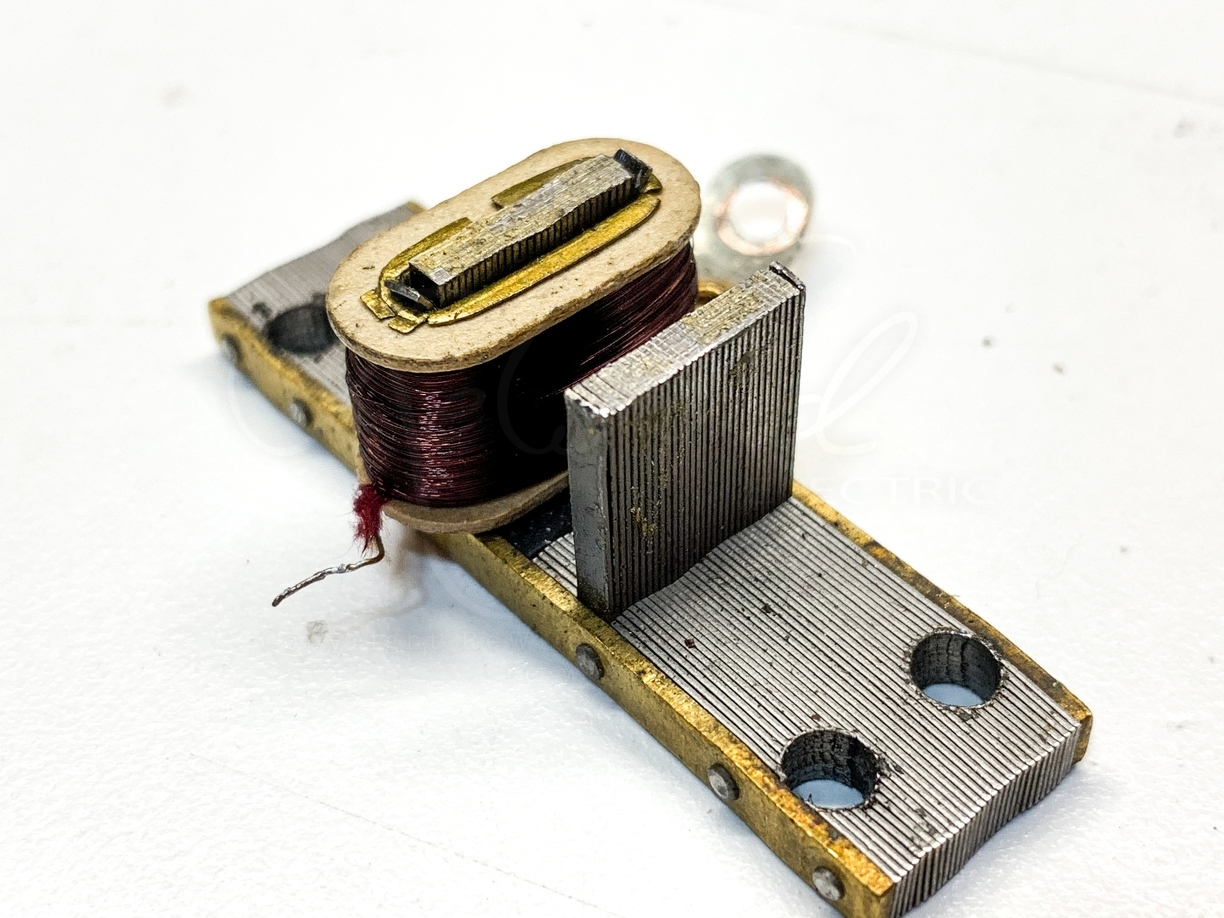

To be clear, humbucking pickups (two coils with opposite electrical and magnetic polarity picking up the same sound to phase-cancel outside noise) were not an invention that Seth Lover developed for Gibson, nor were they a concept that was developed initially for guitar pickups, at all.
The concept had long been in real-world use before Rickenbacker ever electrified a frying pan with strings on it, even in the commercial audio market.
Below are photos of a 1920s RCA Victor magnetic pickup element from a Victrola (phonograph / record player). It's plainly obvious that the design employs a tiny little magnetic humbucking pickup, which is exactly the same design used in guitars. Hand-wound plain enamel wire coils, as well!
Turns out, neither Bill Lawrence nor Larry DiMarzio invented the double blade pickup or the use of stacked laminations, either!

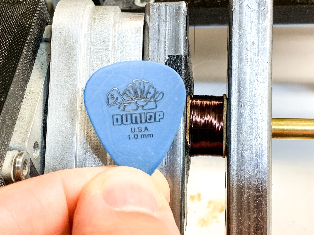

For size reference, here's one of the coils on one of my winding machines, as I repaired it.
Remember, Leo's background was working on radios. Hum-canceling coils were used here, in phonograph pickups, transformers, etc. Hum canceling is also used in push-pull amplifier design and heater wiring. It was a concept that Leo was well familiar with and used. It just didn't meet his goals for his early guitar pickup designs.
